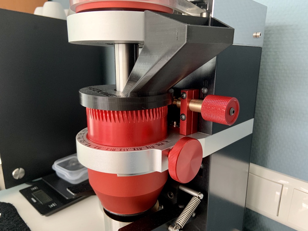

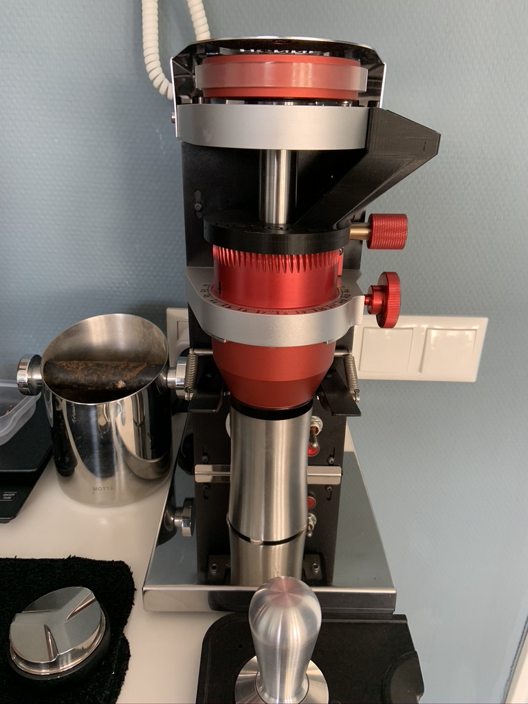

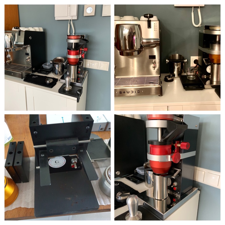

Berichtdoor mihai_b » do 13 aug 2020, 09:14
- the engine - it is a slower one now, and once you stop it rotates in the opposite direction a few times to make sure there is no retention.
- in the last picture you can see the fine grind adjustment mechanism (the red wheel which is turning the red cone)
As bonus I changed both set of burrs, the main axis, the on/off back switch.
Past: Dalla Corte Studio, IzzoDuetto 3 DB, Lelit PL62T HX, Vario
Re: Hedone Honne single dosing maler op de testbank
Berichtdoor bvds » do 13 aug 2020, 10:12
The same burrs new or new design?
Does the slower motor decrease noise as well?
I have seen the Hedonne last year when I visited Bob and did not like the noise and resonance...
