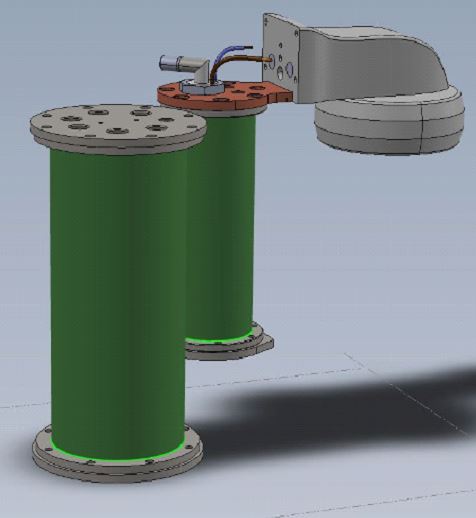

The essential components from the CAD programme:
In the standard version, the group has a thermostat with low hysteresis and heating cartridges, and this already ensures that the group keeps the temperature well within certain limits, regardless of external factors. If a PT1000 sensor is inserted into the group in the area where the brewing water meets the coffee, the whole thing can be improved even further.
So, when the draw starts, the whole brewing system has exactly the brewing temperature: the insulated boiler, the water in the boiler (~270 ml) and the group. The advantage: during the draw, there is no need for regulation and the associated challenges and uncertainties are eliminated. Of course, the boiler may not always be 100% at temperature. This can be caused, for example, by the incoming water. That's why we first direct the fresh water in the heater to the floor, where it can now -- already preheated -- hardly interfere. And if there are still minor deviations in the brewing water, the 3-kilogram sensor-controlled brewing group ensures that these are compensated for.

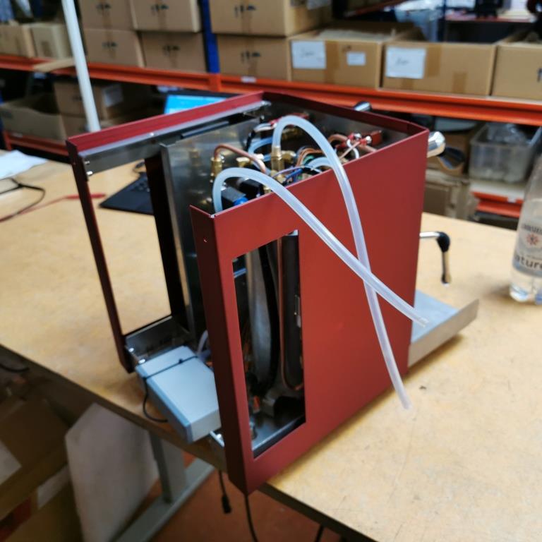

Finally some pictures:
