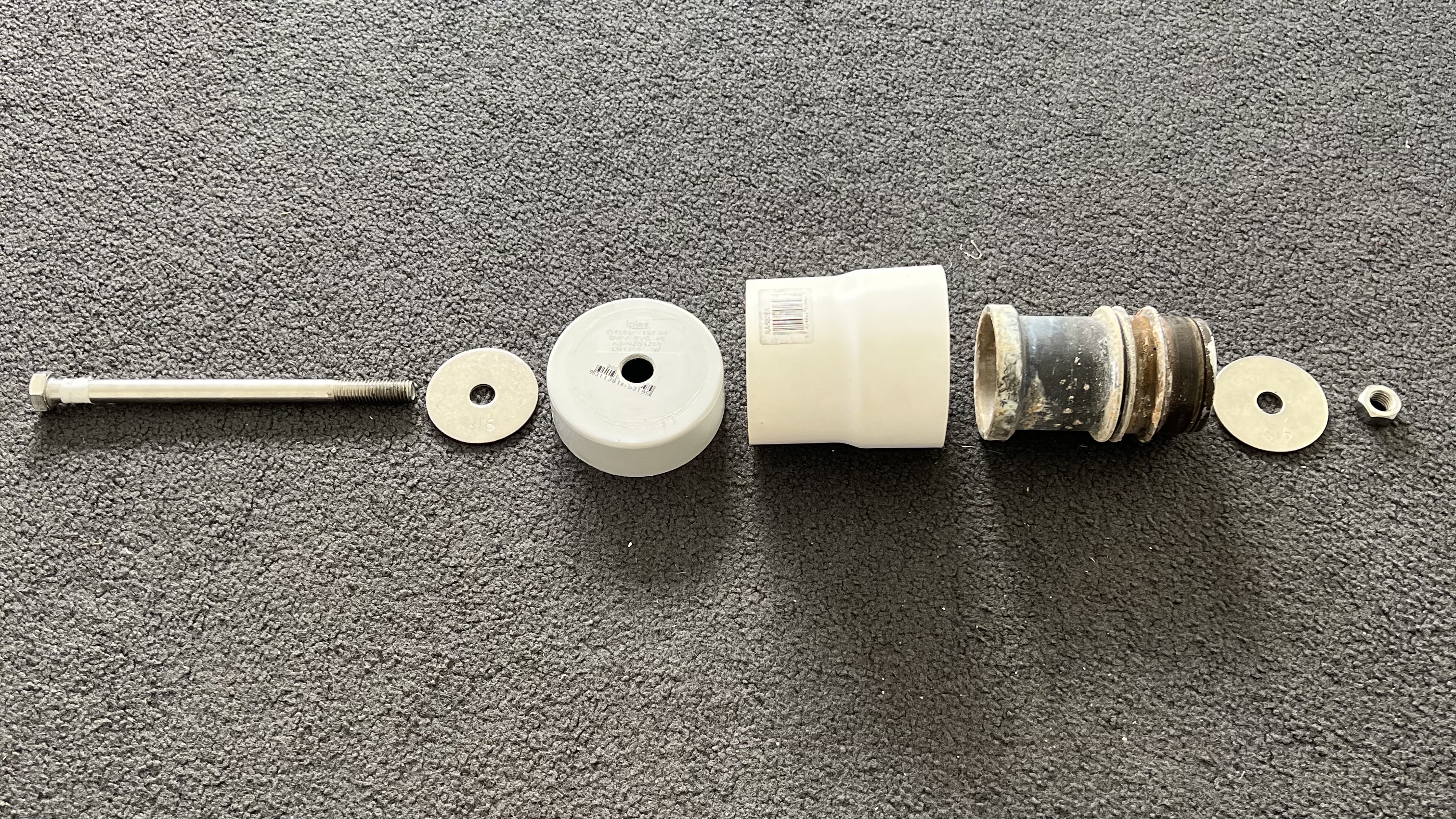

Mijn tool om de sleeve er uit te halen.
Met een gatenzaag de twee cirkels uitgezaagd. Eerst een kleine bout door de grootste ronde. In boormachine geklemd en op schuurpapier tot de gewenste doormeter geschuurd.

Ik zag dat Reiss van Londinium er een heeft samengesteld uit makkelijk verkrijgbare onderdelen en ik ga proberen dat na te doen en er betere foto's van te maken
https://support.londiniumespresso.com/p ... eeve-seals
Here is what you need to buy;
1 x M12 x 180mm hex bolt - i paid a few cents more for 316 (A4) marine grade stainless over galvanised as the threads on galvanised bolts are invariably rough, preventing you from running the nut up the thread of the bolt just with your fingers
2 x M12 x 57mm washers - again i paid a few cents more for marine grade stainless. finding off the shelf washers in 57mm (which i think is 2" 1/4 in old money) was just pure luck; it fits absolutely perfectly over the bottom of the sleeve; if you asked for one to be custom made you would ask for it to be cut to 57mm diameter, it truly is better to be lucky than good. the purpose of the second 57mm washer over the top of the 80mm PVC spouting end cap is purely to protect against the compressive loading of the nut being wound down the thread from smashing the top out of the end cap, so it could be any diameter, the larger the better, but 57mm was the largest i could find as a standard item and it kept the parts list simple
1 x PVC down pipe end cap 80mm diameter, 30mm long
1 x PVC 80mm diameter adaptor, 92mm long - you can cut a longer length of 80mm down to this length if necessary, the end cap simply sits over it
the purpose of just the end cap initially, and later adding in the 92mm length of PVC pipe if needed, is to give you more reach so you can keep winding the sleeve up if it is not free when it rises up above the top of the group body, thus addressing the shortcoming of my original M24 bolt system
Naar de ringen van 57mm ben ik ook aan het zoeken geweest, maar kon ze niet zo 123 vinden. En aangezien je de tool niet dagelijks nodig hebt, leek het in hout ook goed te werken.
Maar als ik de ringen ergens tegenkom ga ik ze zeker aanschaffen.
Een ander optie is om de ringen te printen met een 3d printer.
