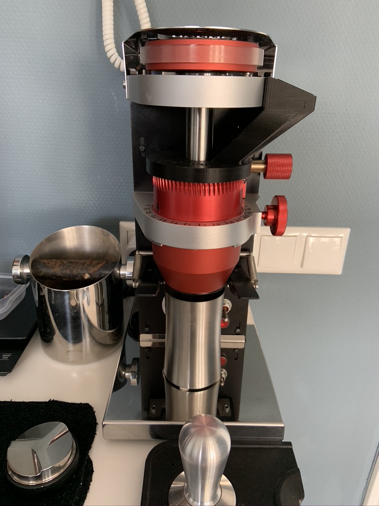

The main 2 upgrades were:
- the engine - it is a slower one now, and once you stop it rotates in the opposite direction a few times to make sure there is no retention.
- in the last picture you can see the fine grind adjustment mechanism (the red wheel which is turning the red cone)
As bonus I changed both set of burrs, the main axis, the on/off back switch.
