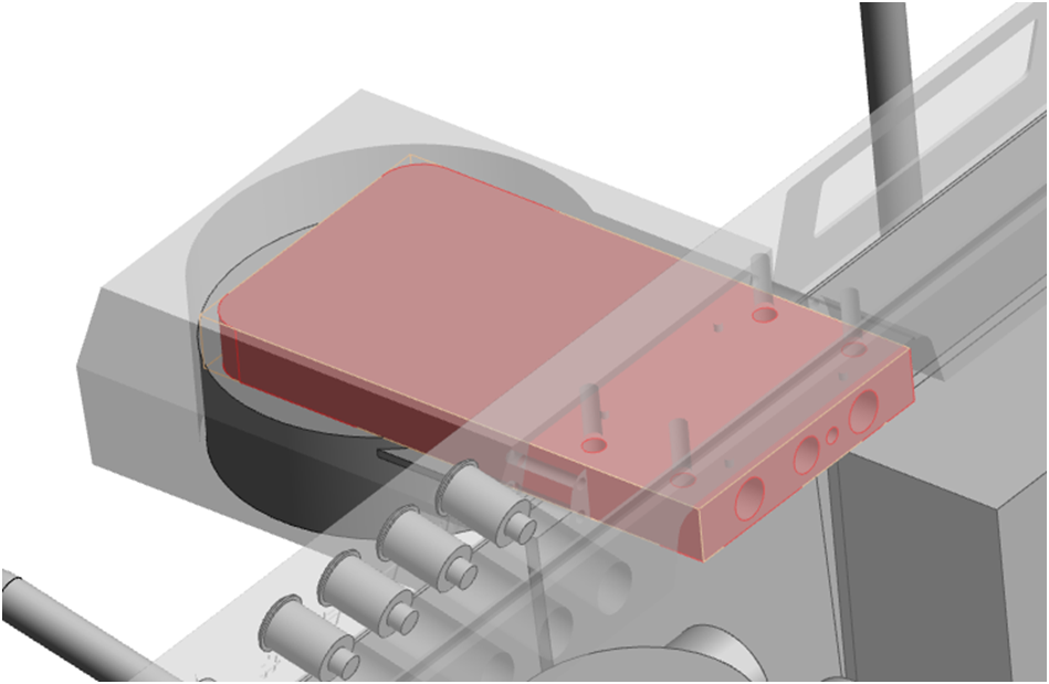

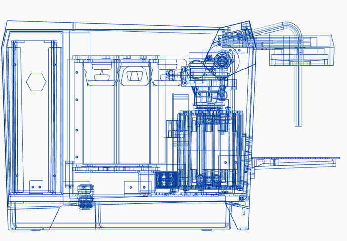

For this reason, we opted for an exposed brew group for this machine. However, we are also sure that even with exposed brew groups, it is possible to contain the release of heat into the environment very effectively. The construction is therefore quite different from the usual. Usually, brew groups are a solid component made of (mostly) brass. The new brew group of the 303, on the other hand, has a multi-part construction: on the outside there is a shell, underneath there is an insulating layer and on the inside there is a core: this is then the actual group and is to be made of copper. Stainless steel would be possible, but we rejected it because the comparatively low thermal conductivity of stainless steel is rather counterproductive for espresso machines.
What you see as a brew group is a type of hood that installs separately from the actual group (the core) and has an insulating layer towards the core.
The core is screwed into the horizontal operating unit via 4 screws and brought into the correct position via spacers.
A positive side effect of this solution: the cover does not get as warm as a conventional exposed group and is also a good protection against contact for children and curious visitors.
The group is heated by 2 heating cartridges that extend almost over the entire length, and these heating cartridges must be precisely regulated by the control unit (in the manner of a PID controller with power regulator).

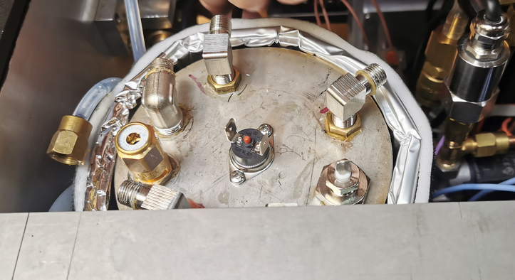

Thus, in this machine, the two boilers are completely sheathed (on the sides at the top and bottom), which effectively prevents heat loss. The insulation is only interrupted in a few places for supply and discharge lines. The construction can be seen in the picture on the right.
We are currently planning a large boiler for steam and a smaller boiler for brewing. The brewing boiler is equipped with a special heating system that makes it possible to heat the incoming cold water inside the heating system before it enters the boiler. This way we increase the temperature consistency.
Each boiler is installed on a support that is also insulated towards the boiler to avoid thermal bridges as much as possible.

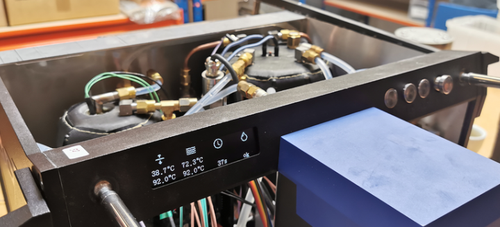

The machine is close to the production and we started to order the 1st parts for the 1st small batch. A few minor changes are needed and in a few days we know the final price.
