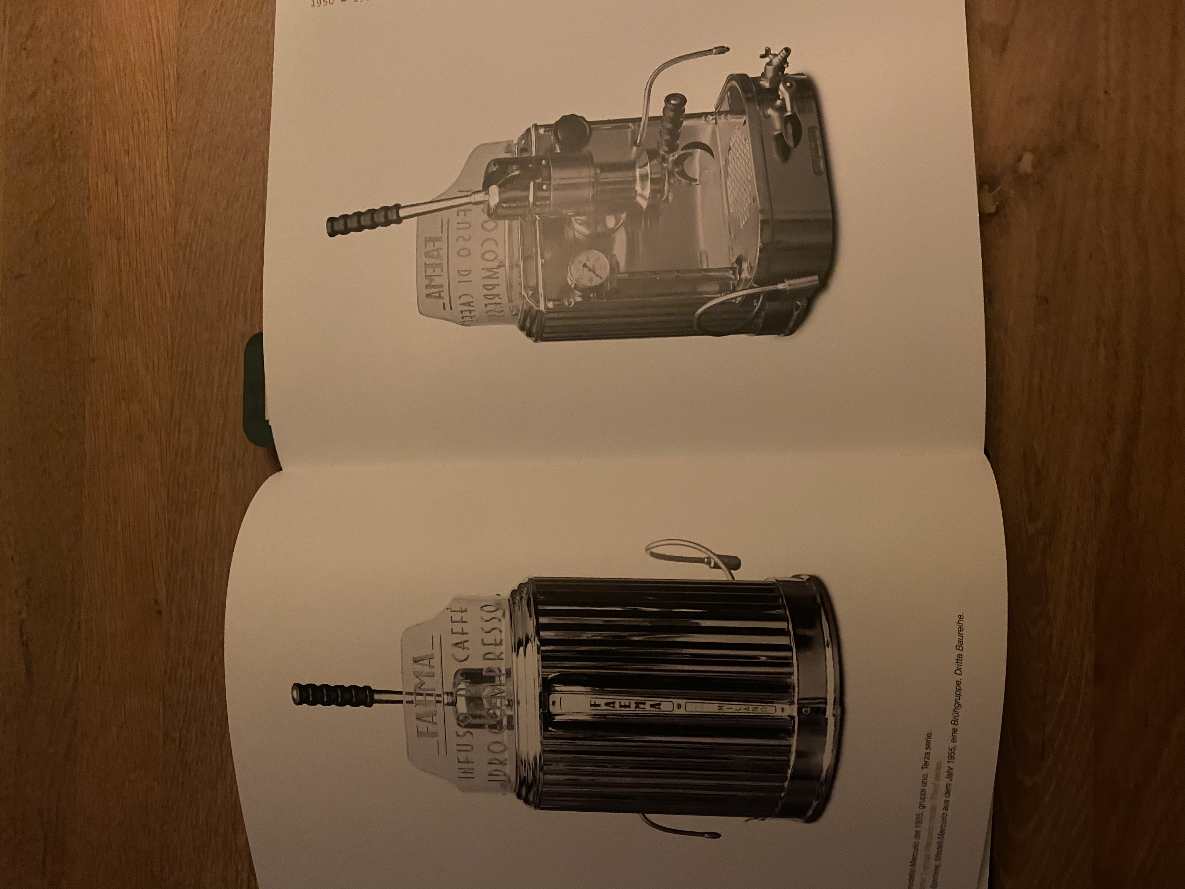

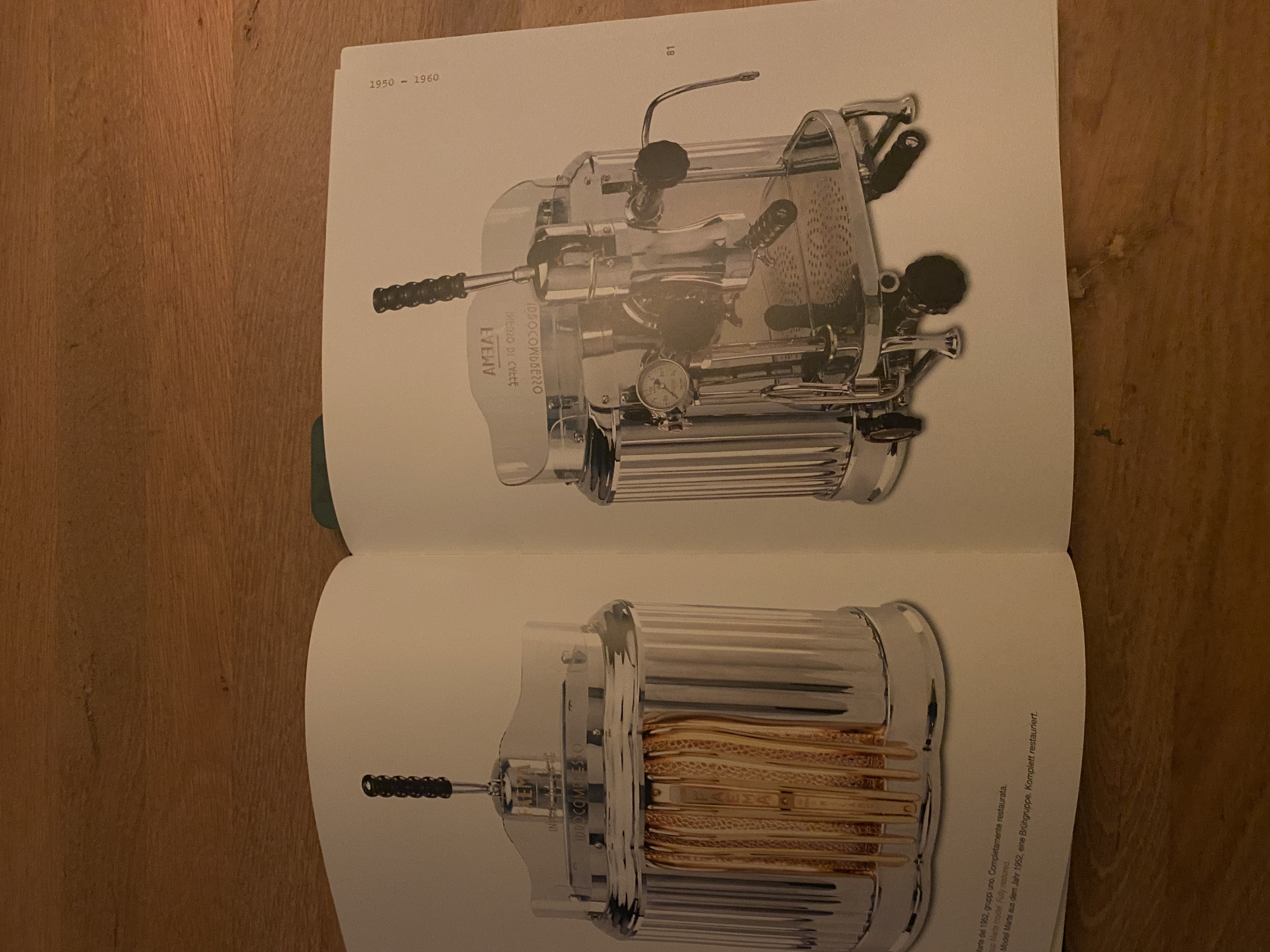

11Ah, thanks, I didn't know. My offered Mercurio has no build in heat element.
Incorrect, the heated group is called Veloxtermo and can be found on very old presidents as well as on the wall mounted Veloxtermo aprox. 1952. The group fitted on this Mercurio is generally referenced as the Vgroup or V style grouphead. The Vgroup is commonly found on Urania models, on a mercurio one would expect a high model round group, but the third series of the Mercurio featured this V style grouphead starting aprox. 1955.SpargelTarzan schreef: do 10 nov 2022, 11:00 Thanks! Geometrically they look similar but not technically.
A velox group has the heat element built in.
Well, they are all nicknames referencing to machines they are commonly mounted to, Faema uses nothing more then "gruppo a leva" which is quite a broad termSpargelTarzan schreef: do 10 nov 2022, 16:31 So a velox group is non existing in terminology thanks pti for this concise explanation.
