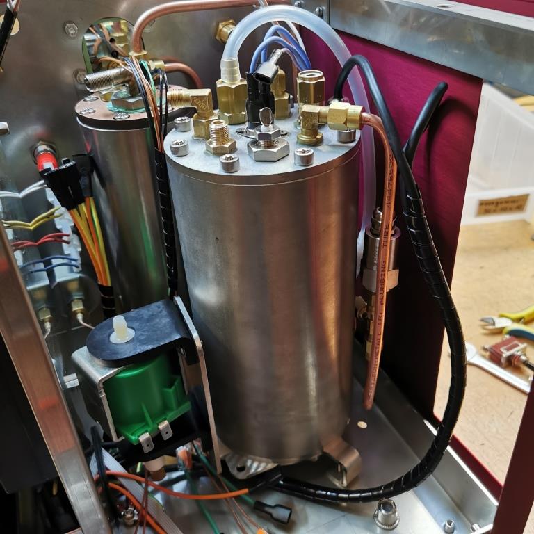

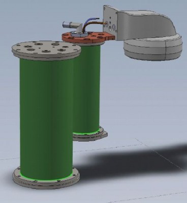

So for the time being, we went with the traditional boiler and a relatively massive brew group. The brewing kettle is dimensioned in such a way that it holds enough water for the espresso-pulling (5 times the amount of a double draw). It thus ensures that there are no fluctuations due to the flow rate. The brew group is given a way to monitor and influence the temperature.
The essential components from the CAD programme:
In the standard version, the group has a thermostat with low hysteresis and heating cartridges, and this already ensures that the group keeps the temperature well within certain limits, regardless of external factors. If a PT1000 sensor is inserted into the group in the area where the brewing water meets the coffee, the whole thing can be improved even further.
So, when the draw starts, the whole brewing system has exactly the brewing temperature: the insulated boiler, the water in the boiler (~270 ml) and the group. The advantage: during the draw, there is no need for regulation and the associated challenges and uncertainties are eliminated. Of course, the boiler may not always be 100% at temperature. This can be caused, for example, by the incoming water. That's why we first direct the fresh water in the heater to the floor, where it can now -- already preheated -- hardly interfere. And if there are still minor deviations in the brewing water, the 3-kilogram sensor-controlled brewing group ensures that these are compensated for.

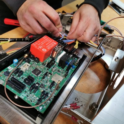

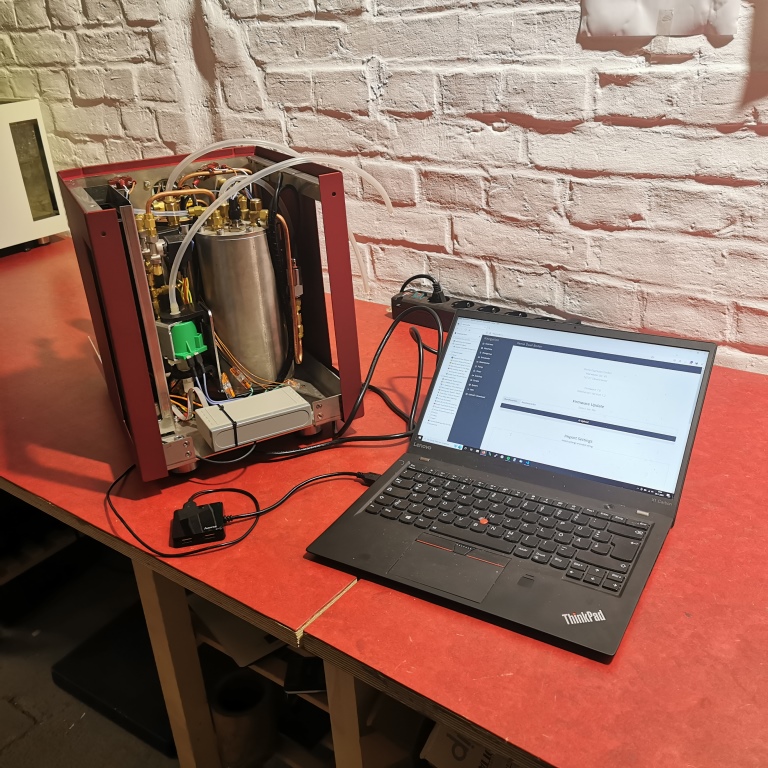

In order for the user to have access to these options, the system has a second processor running a web server that displays all settings in the form of web pages. The advantage is that the user's access is in the form familiar from the internet and is independent of the operating system compared to an app. The presentation of the information is clearly and thematically structured and the essential information is clearly summarised on the start page.
Registration for use with us as the manufacturer is not envisaged and data is not passed on. Updates to the system are simply uploaded.
All in all, a lot of effort was put into the creation of these web pages and so the operation has become intuitive and the system is free of teething troubles right from the start. The software itself is extremely flexible and future-proof and currently has 152 parameters that can be used to make changes and improvements very quickly.

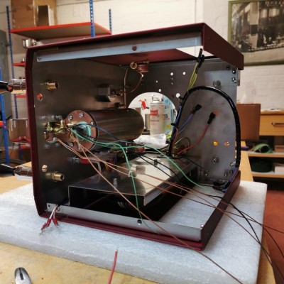

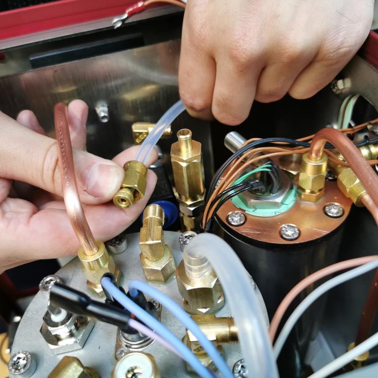

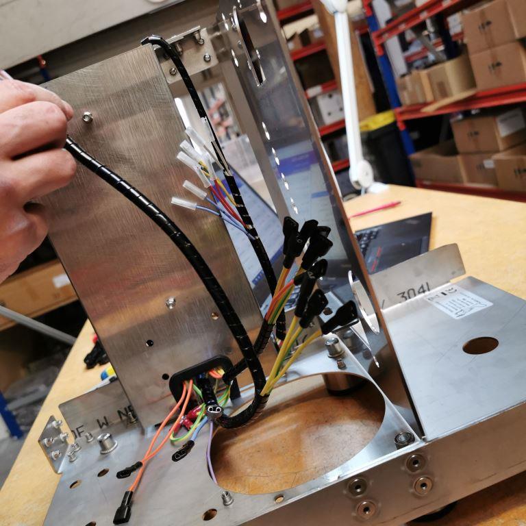

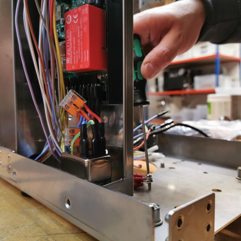

In order to set up a good system, it is also important that the entire structure of the machine keeps up with the concept and the hardware and software. We worked for a long time on the internal structure, on the optimal routing of the water pipes and hoses and on the cabling. The result was an optimal use of the available installation space, and when you open this machine, even a layman can see how consistently this principle has been implemented. Apart from the fact that it looks interesting and confidence-inspiring, this very complex machine is therefore easy to maintain.

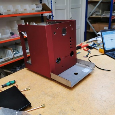

This also makes it clear that we have not suddenly started to become economical in our choice of materials. Plastics are only used if they have advantages over stainless steel, copper or brass in terms of function. The boilers are always made of stainless steel and become more energy-efficient with an insulation of needle felt and another stainless-steel shell. The sheet thicknesses of all parts (1, 2 or 5mm) are more than adequate and give the machine a high degree of stability.
